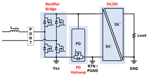

  • Hi Yossi,
    Thanks for your reply.
    PoE PD design power loss mainly are from the rectifier bridge (D1 and D2 in the reference design), PD hotswap, and DC/DC.
    PD IC itself operating power is normally low (< 100 mW). But TPS23755 has integrated primary FET, which may cause higher power dissipation on the PD IC than others. It is hard to estimate the TPS23755 power loss when the FET is integrated. It may be easier to get the transformer power loss from the vendor Linkcom (https://www.linkcom.com.tw/en), and the calculate the PD IC loss by substracting the transformer loss.
    The thermal test was done at ~25C ambient temperature. In this condition the rectifier temperature rise is ~40C and the PD temperature rise could be less than 40C.  Transformer core loss may reduce with temperature rise but copper loss may increase. You may also need to contact vendor Linkcom (https://www.linkcom.com.tw/en) for these information.
