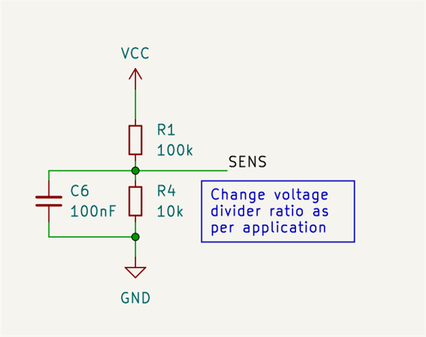

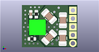

We intend to make an extremely compact 5V module for a nano-scale quad UAV.
Following are the parameters:
Input Voltage 2S LiHV battery 8.4V max
Output Voltage  5V
Output Current 2A nominal, 2.7A max
Cooling Limited natural convection
For the same we designed with the aid of Power Designer:
- using VSet instead of FB
- No Vout discharge
- no PG
uBTIschValidation.pdf
Schematic File --^
uBallLayersPCB.pdf
PCB All Layers --^
uBindLayersPCB.pdf
PCB Individual Layers --^
3D View
Requesting any advice if something needs to be changed.
