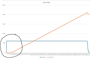

We are observing the low full charge capacity in some of the packs with 2-3AH less than the design capacity. While looking into the charge log files we observed below
1. Some batteries: while charging the battery the battery Remaining capacity is not increasing till some time (approx 2-3AH) and then starts increasing. at the end of the charge the Full charge capacity is reporting 2-3AH less than the design capacity (attached log file).
2. For some batteries: while discharging the Remaining capacity is not decrementing even though the discharge current flowing from the battery after 2-3Ah discharged then the remaining capacity starts decrementing. the same amount FCC is reporting less.
Even though the battery is able to provide full design capacity the gauge reported FCC is less than charged/ discharged capacity value. The above mentioned 2-3AH is difference is not recovering even we perform cycling for more than 10cycles.
Attached the gg file and the log file for reference.
