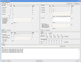

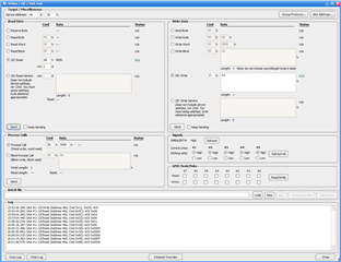

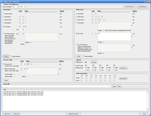

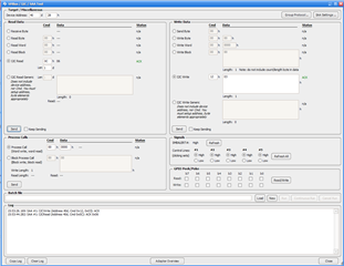

I have a TPS23861EVM-612 which I am controlling using USB to GPIO2, the board is able to power PD's, but the status on below registers:
1. Interrupt - 0x00
2. Port x status - 0x0c to 0x0f
3. Event registers - 0x02 to 0x06
4. Port x current, voltage, resistance registers - 0x30 to 0x3F and 0x60 to 0x67
Do not change on classification and disconnection, I have tried in both auto and semi-auto mode and the behavior is same.
1. PD disconnected:
Only port 1 is enabled via register 0x12, value 0x03
Register 0x0C reads 0x06 -> Expected
2. Connect PD to port 1:
Register 0x0C reads 0x04 -> Resistance valid, but classification is unknown
3. PD is ON:
Register 0x04 reads 0x01 -> Only detection is noted, no classification
Register 0x02 reads 0x00 -> PD is powered, but no change in power good and power enable status
Port voltage, current and resistance registers are reading 0x0000
Firmware version of device is 0x02.
Please let me know if I am missing something.
With Best Regards,
Harsha
  • Please ignore, I found the issue.  SMBus / I2C / SAA tool does not toggle A3 bit on TPS23861EVM-612, it stays high always.  When I referenced address 0x28, reply came from both modules, and data overlapped, which caused incorrect responses.  For U3 on TPS23861EVM-612, I removed the zero ohm resistor R39 and connected pin directly to GND, that way I can reference one PSE with address 0x20 and other with 0x28, and it is working as expected.
