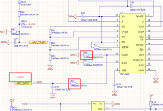

LM74900-Q1: Good way to use the VMON output
Part Number: LM74900-Q1
Hi everyone,
I'm encoutering a strange issue with the current monitor output on my design. The VMon voltage seems to be larger than expected ( comparing to my DC power supply monitoring).
I have question about the good way to connect this output to the MCU. I use a RC filter (R23 and C15) before the MCU and i notice different voltages on each side of R23. Is R23 disturbing the Vmon output ?
