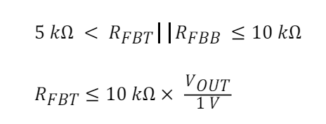

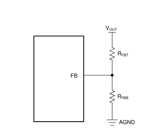

I'm using the regulator LMQ66430R5RXBR to generate 3.8V from 7.2V following the chapter 9.2.3.2.1 (datasheet), I selected Rfbt = 38.03kOhms and Rfbb 13.3KOhms and with this configuration, I obtain well Vout = 3.8V.
But, I wonder if there's a way to reduce the current drawn by these resistance. Basically, I want to limit the current effect of voltage divider.
Is it possible to increase the values of Rfbt and Rfbb while keep an output voltage of 3.8V ?
As you can see in the chapter 9.2.3.2.1, possible values don't allow a wide choice.
