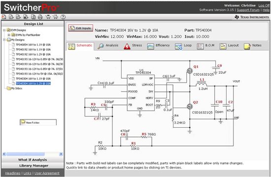

Hi
Attached is an image of the design schematic generated from SwitcherPro from Vin of (12V - 16V) to an output of 1.2V @10A using TPS40304.
From here, the inductor L1 is 1.2uH. However, if we calculate it based on the formula in Page15 of TPS40304 datasheet, the inductor value that i get is 0.6uH.
L = (Vin_max - Vout)/(0.3 x Iout) x Vout/Vin_max x 1/fsw = (16V - 1.2V) / (0.3 x 10A) * 1.2V / 16V x (1 / 600kHz) = 0.617uH
I would like to confirm whether the tool is generating the correct design with the correct value or did I make a mistake in my calculations as the value shown in the schematic from the SwitcherPro tool (1.2uH) seems to be twice the calculated value (0.617uH).
Thanks.
Christine
  • Hi Christine,
    I think the discrepancy may come from the allowance of current ripple -- the factor 0.3 in equation (3) of the datasheet. As a rule of thumb, the synchrounous buck power inductors are sized for approximately 20-40% of the full load current as the peak-to-peak ripple current. Higher the ripple, more loss on the inductor but smaller inductance is needed, which leads to faster transient response and possibly smaller size. The SwitcherPro may use the factor of 0.2 to allow a 20% current ripple. But the factor of 0.3 is also good. So you can pick up an inductor with smaller inductance.
