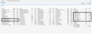

    However, I am concerned that the FCC and QMAX are far apart.
    FullChargeCapacity: 4924mAh
    Cell 1 QMax: 8283mAh
    I'm not sure if this will help, but the FCC rose sharply during charging and then dropped to zero when charging was nearing completion.
    I would like to know if I missed any settings when changing 1m-ohm to 20m-ohm.
