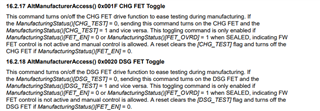

Hi team,
We are using the fuel gauge BQ27Z746YAHR in our new design. Currently we are in a trouble and this fuel gauge is not providing  output at the PACK pin when we connected a 1500mAh, 3.7V Li ion battery. We have found that the FET is not getting the appropriate gate voltage. So that charging or discharging is not going on and the FET is off. When we connected the battery across the BAT pin of battery charger IC (BQ25628ERYKR) our SOC is working properly. Could you please answer the below queries?
  1. What is the default state of this FET? Do we need to program this fuel gauge to detect the battery charging and discharging?
