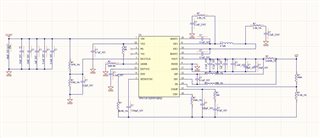

Hello Experts,
I am going to use TPS552872Q IC as my Buck Boost Converter in my BMS project, following are the preset values:
Input Voltage Range = 09 - 32V
Output Fixed voltage = 12V
Max Output Current = 2A
Switching Frequency = 300kHz
Efficiency = 98%
Enable voltage = above 1.2V
In Auto PFM mode
Kindly verify the Schematics and let me know

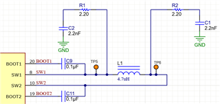

    7. Recommend to add RC snubbers (2.2ohm---1206 package)+2.2nF at both SW1 and SW2 node for EMI consideration, you can leave them floating first and populate them according to the EMI test results.

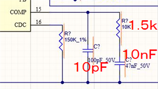

    4. Recommend to change Rcomp=1.5k, Ccomp=10nF and Chf=10pF as below.

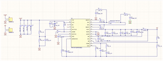

  • Dear Bryce,
    Greetings!!
    1.We have placed CRF1206-FZ-R020ELF 20mOHM (1206 package) Resistor as recommended.
    2. 0.1uF cap is placed near VCC along with 4.7uF.
    3. We have placed 4.7uhH inductor with ISAT of 5.9A (SPM5030VT-4R7M-D).
    4. Changes has been done according to your recommendation on 'Comp' pin. (Please refer the attached schematic)
    5. We have updated the voltage rating of the snubber caps to 50V for SW1 & SW2.
    6. We have added 100nF and 10nF MLCC (50V) in the output although in further circuits we have added significant input capacitors to improve the performance in load transient.
    Please find attached schematics for your review:
    /resized-image/__size/320x240/__key/communityserver-discussions-components-files/196/pastedimage1719988596493v3.png
    Abhiram Tiwary,
    Hardware Design Engineer

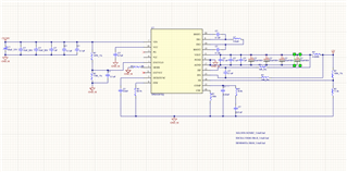

  • Hi Abhiram,
    Please note that for MODE pin, you need to leave R3 or R5 floating to select PFM or FPWM. Others look ok for me.
    BRs,
    Bryce
  • Dear Bryce,
    Thank you for your kind support, we have kept the R5 as DNP and R3 as initial provision to FPWM
