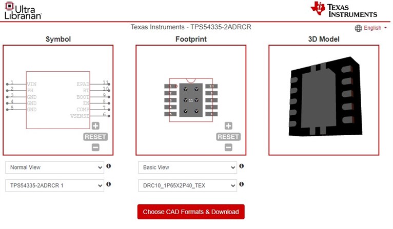

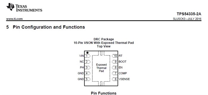

Dear e2e Support,
There are differences (pin 2 and 3) between the TPS54335-2A datasheet pinout and the related Ultra Librarian one.
Can we fix it and provide the related files in the meantime?
