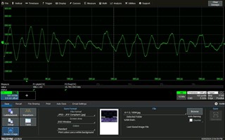

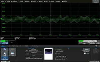

We've configured two LM5122 Synchronous Boost Controllers to work as a master/slave pair, but we're getting a fair amount of subharmonic current oscillations on the power input line. The input voltage range is from 25V to 35V and the output is set for 55V. We should be able to supply about 700W continuous, with brief peaks of up to 2000W. The oscillation amplitude is several amps peak-to-peak, of which the main component is an 18kHz sine wave at lower power levels, or a 96kHz sine wave which starts to dominate at higher power levels. Unfortunately, we are limited to only 80uF of input capacitance and 140uF of output capacitance. We were able to reduce the amplitude of the oscillations by adjusting the slope compensation K factor, and right now we have a value of 1.5 which is giving us the best results so far. The current sense resistors are each 1.5mohms, the undervoltage lockout is currently set to 20V, the Vcc caps are 10uF and the BST caps are 470nF. The boost inductors are each 8.2uH and the PWM switching frequency is set to 300kHz. The feedback compensation network parameters are as follows: Ccomp = 33nF, Rcomp = 10kohm, and Chf = 560pF.
I've attached two scope plots of the input current (AC-coupled, 1A/div) under two different load conditions (100W and 500W).
Another significant problem we're encountering is that the channels are unbalanced, with the master circuit supplying significantly more power that the slave circuit.

    Based on the given parameters, the LM5122 in two phase topology should be fit for the application. Inductance and fsw should be okay as well.
    I am concerned about the low output capacitance.
    Low output caps and an aggressive compensation network may lead to RHPZ instability. I would recommend to double check if the compensation network is stable for the given operation conditions. You can use the Power Stage Designer tool for this:
    https://www.ti.com/tool/POWERSTAGE-DESIGNER
    The inbalance of the current sharing may also be related to the oscillation of the output voltage.
    Just for debugging purposes, would it be possible to attach a large bulk capacitor to the output and see if the design runs stable then? If the instability still consists, we may need to look deeper into the rest of the design.

  • Thanks for the prompt reply Niklas. The worst-case output voltage ripple is about 2.5Vp-p and reduces to 2Vp-p when adding a 470uF capacitor to the output, but the current oscillations on the input line are still quite large. Adding an EMI filter prior to the input reduces the current oscillations, but the instability is still present. The MOSFETs do not have snubbers at the moment, but there is the provision to have them mounted, could this reduce potential ringing that may be leading to the instability?

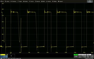

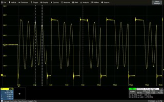

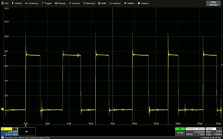

  • Attached is a plot of the low-side gate drive signal (at an output load of 100W); it seems as though the duty cycle exceeds 50% every now and then. Also, there are two plots of the switch node (no load and 100W). Since we are configured in diode emulation mode, there is ringing at the switch node once the inductor current discharges and the node voltage drops below the output voltage level. Finally, the VCC voltage seems rather noisy.

    I agree there is some switch node ringing, but I am also concerned about the large negative overshoot on the switch node of almost -10V.
    Snubbers should be a good approach, but this may not suffice in fixing noise on VCC.
    If the noise within in the system is layout related, it is difficult to solve this on schematic level.
    I do not have the schematic or layout files available, so all of this is based on speculation, but can check double check the design for separation of analog ground and power ground? Is the power stage compact and routed effectively? Is the design using solid pads at the power stage (no thermal relief pads)?
