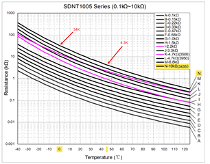

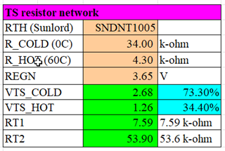

  • According to the datasheet the Battery manufacturer sent me for the 10K thermistor they put in the battery, the 0C and 45C resistance values are 34K and 4.3K respectively. Please see what I placed in the calculator below and verify that it looks correct. Also, how can I be sure that the BQ25628 will not charge the battery above 45C degrees? A VTS_HOT of 1.26V is not really a value that means anything to me.
    The values look correct. The numbers in blue correspond to a ratio of the TS voltage to the REGN voltage. These ratios hold independent of the REGN voltage. These ratios are explained in  8.3.5.4.2 TS Pin Thermistor Configuration. The ratios are documented in THERMISTOR COMPARATORS (CHARGE MODE) and THERMISTOR COMPARATORS (OTG MODE) in the datasheet.
