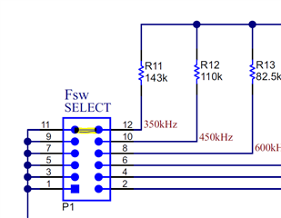

  • One more important data, Sorry I didn't mention, to get 1V, I did what mentioned the first row  in table 2-1, so I changed the jumpers p1, p2 and p3 accordingly.
  • Hi Shitaye,
    Yep jumper setting for 1V is good. The frequency setting however is at 450kHz on the EVM while the data show in datasheet is 400kHz. So, swapping the R12 to 124kohm will change the 450kHz jumper setting to 400kHz. Lowering the frequency may help increase the efficiency. If you can, please take a picture of the final board configuration with jumpers and send it so I can check how the settings are.

     I moved the jumper P1 to the top, 350Khz (please refer to the picture below), based on the recommendation in datasheet  Table 2-1 . what did I miss?
  • I was under the impression you needed to check efficiency at 400kHz. Jumper setting is fine at 350kHz for 1V. With this 350kHz setting the efficiency should be slightly higher than the 400kHz data shown in the user guide for 1V. I can check on the EVM here too but can you post your input voltage, input current, output voltage and output current raw data you took here?
