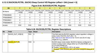

  • I already have a question:
    The spec refers to a 'Sleep Voltage' controlled by CTL6. What is this exactly?
  • Hi Michael,
    This just means that you can pull CTL6 HIGH or LOW to select between two different voltages on a power rail. One voltage is the normal default value and the other voltage is the "sleep voltage" which is usually some lower voltage value. Different version of the PMIC have slightly different voltage settings but that's the general behavior.
    Below is an example of the BUCK3 register setting for sleep mode enable. CTL3 can also be programmed as a sleep control pin.
    James
