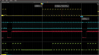

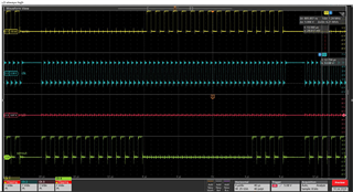

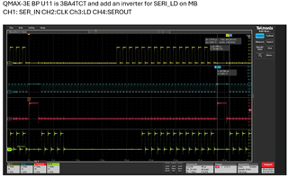

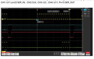

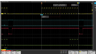

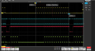

Hi Sir:
   We design TI TPIC6A596 chip in several prjects.  The TPIC6A596 function was ok and these products were MP from 2018. However, our factory finds if we load the IC TPIC6A596 with the new FAB site DMOS6, the TPIC6A596 can't work. The fail rate is 100%. Once we change to TPIC6A596 with DL-LIN, the function works normally.

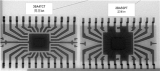

We also use X-ray for the two different site TPIC6A596 IC. The IC layout is different. Please see the attached file. 3BA4TCT is DMOS6 and 3BA5SPT is DL-LIN.
We want to know why the IC layout is different.
From attached PCN, TPIC6A596 spec is not changed. Why does the function can't work if we use the TPIC6A596 with the new FAB site DMOS6? Thank you.
