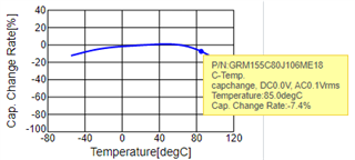

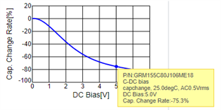

May I know if it is possible to take power efficiency simulations and frequency response simulations with the condition below? My customer cannot use pspice for TI due to IT security issue.
1. Vin=+3.3V, Vout=+4.7V, Iout=0.84A, Effective capacitance of Cout is 2.6uF
2. Vin=+3.3V, Vout=+5.0V, Iout=0.4A, Effective capacitance of Cout is 2.6uF
x-axis of power efficiency simulations is load current while y-axis of power efficiency simulations is efficiency.
x-axis of frequency response simulations is frequency while y-axis of frequency response simulations is amplitude and phase.
