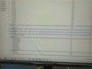

BQ76952: Command for full reset BQ7695202 and Current accuracy
Part Number: BQ76952
1. We want to full reset BQ7695202 IC through software command (host controller). Please suggest the procedure and commands

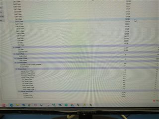

2.  Accuracy of current is varying approx. 2 Amp.
Steps to calculate CC gain -
1. R sense is 1mohm.
2. Putting the R sense value in the CC gain formula as per given in TRM value is 7.4768 = (0x3F3DF3B6).
3. Capacity gain as per TRM value is CC gain x 298261.6178 = (0x4A082510).
Accuracy of current is found wrong. Please suggest the procedure
