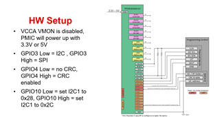

TPS6594-Q1: EEPROM is locked in fresh PMIC
Part Number: TPS6594-Q1
We are trying to be programming a fresh PMIC through EVM by using Scalable PMIC GUI software. For fresh PMIC, we are using I2C address as "0x28" for connecting hardware. Our Hardware is showing connected, but while we are programming our file it is showing that EEPROM is locked.
We are using "TPS65940400RWERQ1" PMIC.
