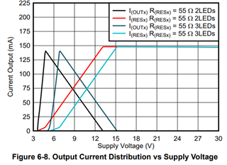

I have a question regarding the working mechanism of this thermal sharing feature of TPS92623.
I understood that the current will be shared between two pins RESx and OUTx depending on the supply voltage level in order to reduce the thermal accumulation in TPS92523.
What I am curious about is the mechanism behind this. How does the IC know when to increase the current on RESx path and reduce current on OUTx, and vice versa? Is there any kind of current monitor happening in order to detect when to switch between the two pins?

    As you can see, the output current distribution between the RES path and the OUT path will change according to the Vin and Vout, but the total output current can be constant.
    The RES resistor is used to set the current of the RES path, When the Vin rises, the current of the RES-path increases, and the current of the OUT-path decreases, then more power will be shared by the RES resistors.

    Thanks for your answer. I totally understood the functional of TPS92523, what I am interested in is the working mechanism behind that.
    Is it okay to think that the current is distributed by comparing the current with an operational amplifier or something inside and turning the transistor on/off?

    I think it's similar to the latter.
