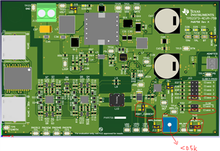

I'm facing issues powering the evaluation board by a PSE with a standard crossed cable.
I've tried to power a standard PoE device with same setup PSE+cable and it works, hence the problem is related to the development board.
Any help to understand this issue?
Thank you in advance for your help.

  • Hi Francesco,
    Thanks for your reaching out.
    - May I know if it is a new TPS2373-4EVM-758 and it "failed" at the 1st test?
    - Is it an open load test or your have a load? If have a load, what is the load power?
    - The "failure" could be a configuration issue since there are some jumpers on the evaluation board. Please configure as:
    J11 short
    J12 short
    J5 short to VSS side
    J10 select Class3
    J7 select Class4
    R39 make its resistance less than 0.5kOhm
    - If above methods do not work, could you let us know the PSE part# and send us the register data of the PSE so we can check what is the failure.
