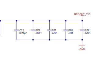

Hi Pradipta,
The WVB in the AWR2944EVM is LM63635. Customers need to monitor the output voltage and current of LM63635. How to achieve it?
On this forum we can answer queries specific to radar sensors. For queries related to LM63635 only their product line can provide the accurate answers. Let me change the forum page so that the query can be directed to the concerned team.
Pradipta.
Hi Ghohai,
To find VOUT, you need to probe the top and bottom terminal of these capacitors.
To find IOUT, you need to do some PCB surgery. You would need to put the Inductor sideways, and measure IOUT with a current probe with a wire to the pad.
