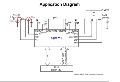

BQ25713: The difference between VBUS wiring before and after precision resistance
Part Number: BQ25713
Should the VBUS be connected in front of the precision resistor or behind the precision resistor, what is the difference between the two? Because I've seen some of Google's designs put in front of precision resistors. Please help answer, thank you ~
    There is no difference, VBUS can go before or after the sense resistor.
