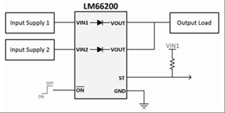

Do we have higher current oring device? Current need is >6A, but I found that LM66200 only supports 2.5A. Input channel should be 2.

We would not have anything higher current in a single package, however might be able to do this with two separate idea diodes or load switches. Would two devices be OK here?

Note you can also use the TPS2117 in priority mode and the functionality will be very similar compared to LM66200.

The current rating of TPS2117 is only 4A ,cannot still meeting requirement.

In this case, we would not have an integrated solution with increased current capability. You could possibly use two separate devices such as load switches, however we would not have an integrated solution.
