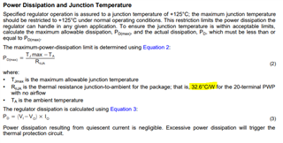

  2. In equation 2 of the datasheet (seen below), does the formula apply when the device thermal pad is connected to an external thermal plane? The Θja is listed as 32.6°C/W, but that doesn't match the values we have set in the EC table.

    2. The 32.6 C/W states that it is with the PWP package but with no airflow. I am assuming that the 74.1 C/W is with airflow. It could also be a mistake when editing the datasheet. Typically, we use the 74.1 C/W to calculate thermals.

    After talking to a designer, I believe this is what happened to the Θja value in this datasheet:
    "The customer needs to qualify their design with the theta-JA value specified in the thermal information table i.e. 74 ⁰C/W."
    The 32.6 C/W was accidentally copied over from a different datasheet and was not fixed or updated. The designer thinks that the description was copied from the TPS701 datasheet.
    Hope this helps!
