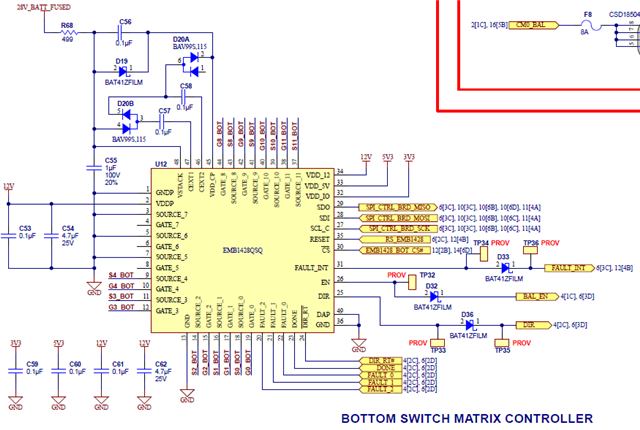

I would appreciate your input on an issue I've encountered today.
I'm utilizing the EMB1428 and EMB1499 chips for cell balancing. According to the datasheet, "the EMB1499Q features an integrated watchdog timer that automatically powers down the forward converter after 8 seconds of uninterrupted operation. To maintain charging or discharging a cell for more than 8 seconds, the microcontroller must send a stop and start command at least once every 8 seconds."
However, I've observed that charging only lasts for 2 seconds (instead of 8 seconds) before shutting down, whereas the discharge cycle completes the 8 seconds without any problems.
Even when I attempt to send STOP & START commands every 1 second to sustain the charging cycle, it halts at 2 seconds, pauses for 1 second, and then resumes the charging cycle. It consistently stops at 2 seconds with at least a 1-second idle period before restarting.
Additional observations: The charging cycle operates continuously for 8 seconds when VSET is set to 1V or less, but fails to do so for VSET values greater than 1V.
But as per datasheet "Supported values for VSET range from 1V to 2.2V".
My equation (FYI):
DAC Output = (desiredVoltage / vref) * (resolution - 1)
vref = 3.3V, resolution = 2^8 => 256, desiredVoltage = 1.0V
I kindly request your advice on this matter.

    Balancing current is set using VSET and the secondary sense resistor. Which value are you using for Rsense? We also recommend VSET to be set to 2v. When starting cell balancing, is voltage on VSET maintained? Is this an issue that you see on only 1 device or multiple devices?
    Zachary
  • I initially set the VSET to 2V as recommended, but I encountered an issue where the charging only lasted for 2 seconds. To troubleshoot, I explored other VSET values. As I mentioned earlier, the problem occurs when the VSET exceeds 1V. The VSET value remains constant during runtime and consistently stays at 2V. I’m using a 10m Ohm Rsense. Currently, I’m testing this on one device; I haven’t checked the other one yet.
    Feel free to refer to the schematic of my system below:
  • Thank you for your schematic.
    Are you able to monitor the EN and DONE pins during an operating cycle? Is EN toggled LOW and DONE toggled HIGH after 2 seconds? Are any FAULT pins being asserted after the cycle? Furthermore, 8 seconds is the maximum operating cycle length before watchdog shuts off the forward converter. This doesn't necessary mean that a cycle needs to last 8 seconds. While VSET = 1V is technically within the operating conditions of the device, our testing was done with VSET = 1.2 - 2v. It seems at 1V, watchdog is manually shutting off the operating cycle.
    Zachary
  • Yes, I successfully observed the EN and DONE pins behavior. The charge cycle completes successfully in 2 seconds, with EN going Low and DONE switching to High. Additionally, I checked the fault bits and consistently received 0xA0 for stop, 0xA2 for initiating a charge cycle on cell 2, and 0xAA for starting a discharge cycle on cell 2, without detecting any faults.
    My goal is to maintain the charging process for 60 seconds, intending to alternate between stop and start commands every 5 seconds to sustain the charging activity. However, the attempt to keep the charging ongoing with a 5A current for 8 seconds, as specified in the datasheet, by setting VSET to 2V using a 10mOhm resistor to achieve approximately 4.6A, does not succeed. Do you have any suggestions?
