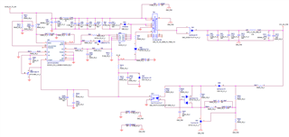

Customer used LM51551 for the application 9-36Vin to 54Vo/0.6A. There were two diodes they have tried.
1. DM1 used 200V/3A Schottky diode SM3200B.pdf. Loading is good and can be used up to full load.
2. DM1 used 600V/5A Ultrafast diode MUR5U60(TO-277).pdf. DM1 would be very hot and smoking. We would also observe the input power supply current keep increasing.
Could you please have a look and advise how to choose the rectifier diode properly and what might goes wrong with the schematic?
Schematic:
xfmr: PL3254-001SR_SPEC_A.pdf
UM2 MOSFET:
MTB013N10BRQ8.pdf
Allan

    From my calculations, the peak current through the diode is 6A in you case. The 600V diode has a significantly higher forward voltage drop and with that a higher power dissipation (more than 7W peak). This might be too much for the package size. I recommend using a diode that is made for higher currents. In this case i would choose one with at least 10A rating.

    Thanks for prompt reply. Customer had also tried with two 600V diode in parallel (so current rating should be ok?) but still can't get stable output at full load 30W. We thought something relates to stability. Also want to clarify that the peak current 6A through the diode should only happened at the lowest 9V input condition but the test customer did is using 12Vin.
    p.s. originally Rsns used 10mohm but can only power up, would shutdown as load increasing. Rsns changed to 2mohm but can only power up to 15W load. After 15W load, system seems unstable.

    Paralleling Diodes is not a good idea. One Diode will always take most of the current.
    Also at 12V input, the peak current will still be 5.5A.
    Currently the customer is using a transformer ratio of 1:1. This will result in a very high duty cycle. This might be the main problem.
    For a flyback, a max. dutycycle of 50% is recommended. Please have look here: https://e2e.ti.com/support/power-management-group/power-management/f/power-management-forum/546358/maximum-duty-cycle-of-a-flyback-converter
    I would recommend to use a ratio of 1:3.

    Customer referred a similar reference design PMP20588 and the transformer Pri: Sec is 1:5.
    The transformer customer used Pri:Sec PL3254-001SR_SPEC_A.pdf is also 1:5(not 1:1).
    Could you please review again what might be wrong?

    I would recommend to place a snubber across the rectifier diode to supress the large ringing and spikes.
    From the schematic, the rest seems to be ok, can you please measure some more waveforms?
