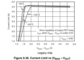

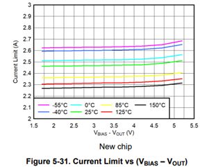

TPS74901 is a 3A LDO. Why is the current limit of the new chip less than 3A?
Sam Ting
We found some anomalies in the datasheet for the new device. The current limit as per Galileo is around 4.5 A. Please give us 2-3 business days to figure out the source of the anomalies and confirm the current limit. Should I send the summary of EE differences now or would you wait until next week when we have resolved the limit issue?

Per Sec 6.3.3 of the DS, "The current limit allows the device to supply surges of up to 4A and maintain regulation. The current limit responds in approximately 10µs to reduce the current during a short-circuit fault."
The DS also shows the min, nom and max values of the current limit. Please disregard the graph you had earlier referenced.
