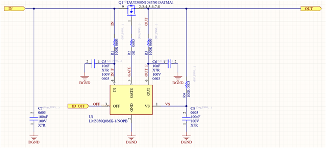

Hi!
I have 200A application, I want to put 10 MOSFETs in parallel.
Should I drive all 10 MOSFETs from one LM5050
Or it is better to parallel whole LM5050 solution?
I have noisy environment with transients, that may trigger LM5050 off
Mosfet is 200nC total gate charge, I see current for gate specified like 30uA.
As I understand it will take around 10ms to turn on MOSFET
If I parallel 10 mosfets, it will take like 100ms to turn it back.
What do you think?
Stas
