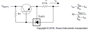

TL432-Q1: Regarding the design calculations
Part Number: TL432-Q1
Other Parts Discussed in Thread: TL432,
Part Number: TL432A-Q1
Dear Texas Instruments Team,
Urgent information required on how reference voltage, cathode voltage   and cathode current was adjusting based on inputs for IC TL432. We are conducting a worst-case analysis, and this data is critical for our project timeline.
input voltage - 10v ,
input current-10mA
r1 -2kohms
also, if possible, can you provide design calculations sheet for the below design, it will be very useful for us in conducting analysis
