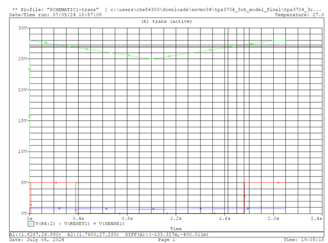

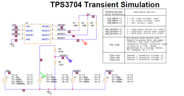

When Simulated TPS37043BJOFDDFRQ1 in PSPICE,
VDD=3.3V
Vin=28V
UV Reset triggers at 4%
But OV Reset triggers 2.5% instead of 4%
PFA plot.
Thanks and Regards,
Vidhya

Hello Vidhya,
I apologize for the delay. I did simulate the model on my end and did noticed their is a 2.5% error in the OV threshold. I will report this to the team but it will be a while before the model is reviewed and the source of the error is determined. Considering this error is there any device behavior i could clarify for the customer?

Hello Vidhya,
Unfortunately we did not currently slated for revision, I have made the team aware of this and it will be added to the queue. With that being said it will still take a couple months before a model is released to the software.
I can assure you that same window size applied to both the OV and UV.

Hi Oscar,
Will consider 4% for both OV and UV for TPS37043BJOFDDFRQ1.
