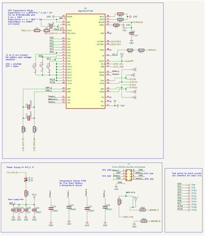

Please experts in the house help! My design is based on the EVM board and for testing i have the following settings as per
the sample code for STM32. I am a novice, please forgive my desgin quality.

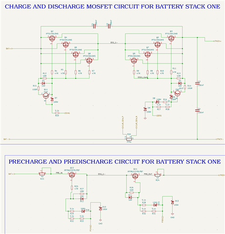

Any ideas why the fullcan bit is never asserted. Charge FET is always on!  Attached is my design scehmatics.

  • I have four test points on the BQ76952 to monitor the CHG(and PCHG) and DCHG(PDCHG) pin voltages that drive the gates of respective MOSFETS. Currently, I am using a voltage divider circuit to provide the six cells inputs to the BQ.
    In Test mode when i supply say 18 volts (as battery voltage) and send Test commands, I get about 9 volts for the PCHG and PDCHG test point, while CHG is at 36volts but DSG remains at 0.22volts.
    Changing the supply voltage, the corresponding test point voltages rise according with the PDCHG rising above supply voltage when test commands are sent.
    Same behavoir in Normal mode, all FETS get turned on appropriately except for DCHG pin (test point) that remains at 0.22Volts.
    I can read cell voltages and temperature correctly but the DCHG pin of BQ remains at 0 volts. FETs are enabled in magnufacture_init register.  Alert pin is also asserted.
    Essentially, DCHG pin voltage remains at 0 volts in all modes. Replacing the BQ did not help as well.
    I expect the discharge to also pin voltage to also be above battery voltage when turned on or what am i missing.
    Any pointer will be appreciated.
    Thank you.

  • Hello Alexis,
    thank you for the feedback. Just discovered it was a design problem as some FETs have their terminals swapped. I am able to controller the CHG & DCHG FETs now. FET Status returns 01000101.
