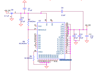

Hi ,
I am using LMZ34002RKGT for +5V to - 5V conversion. output is not generating . Attached my design please check if I am missing any.

Hi Akhila,
Did you try shoring INH/UVLO to VIN? Maybe your divider voltage is too small.

Yes, I have tried that and also tried by floating INH/UVLO still there is no output.

Hi Akhila,
STSEL is connected to A_VOUT despite there being no SS capacitor. Can you try disconnecting STSEL or adding a soft start capacitor?
