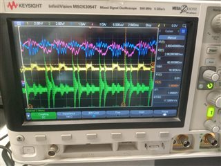

I am Testing a 3.3kw interleaved PFC using UCC28070
Input AC voltage: 230, 50HZ
the output voltage is 400V regulated by IC
But As I am loading the PFC to the current waveform is becoming more of a square type and PF is becoming less. What could be the problem
I can share the schematics in mail ID
  • Hello Hema,
    The waveform shown with long "deadtime" around the zero-crossing suggests to me that your DMAX resistor value is too low, causing a low maximum allowable duty cycle.
    The dead time may always be there, but at light loads, the line current peak is lower so it may not appear to be very square.  But at higher loads, the center peak has to rise and the overall input current looks more "square" as the load increases.
    If that is not the case, another possibility is that you have too much offset voltage on the CSA and CSB signals.
    Please check to see if there is more than about 100~120mV DC offset voltage on these signals.  If so, please reduce it.  Sometimes no offset at all is necessary.
    Ulrich
  • HI Ulrich
    The Dmax resistor value was high enough for the Duty cycle of 94 percent
    I have decreased the offset voltage from 200mV to 100mV for the current sense but still, the waveform is not improved
  • Hello Hema,
    Thank you for the schematic file. It is helpful.
    Several of the components around the PFC controller have two values listed: one in black text, one in red text in parentheses.  Which of the values should be applied to your design?
    Reviewing your waveforms again, I see that the "O/P current" (CH4) has humps that correspond to the humps in the AC input current, and it has flat spots that correspond to the zero parts of the AC input current.  But the DC O/P flat sections are not zero current, so the PFC power stage appears to be getting input power from a DC source of some voltage between 0V and the AC line peak.  Can you please check for this?
    Also, where is the O/P current probe located?
    Ulrich
  • The text with black ones is mounted on the board.
  • The output is connected to an electronic load with a  CC current of 2.5A  and the current probe is connected around  a DC positive wire which is  connected between pfc output and electronic load
  • Hello Hema,
    Thanks for your replies.
    I am trying to make sense out of the O/P current waveform based on your load description.
    A CC load should show as steady-state DC current, with little or no AC ripple.  Your waveform has a lot of AC ripple.
    The only way I can make sense of this is to envision that you have substantial output capacitance at the e-load end of the positive wire, and the current probe is measuring the ripple current into that capacitance.  The e-load current itself may be strictly-flat DC, but the probe is not measuring that.
    Can you check for that situation, please?
    Aside from that, can you also capture SS-pin, VSENSE-pin, VAO-pin, and IMO-pin voltages all at 1V/div with zero-references all on the same horizontal line, please?  Set time sweep to 5ms/div.  Use the same input and output test conditions as in your screen-capture, above.
    'Scope bandwidth limit can be 20MHz (or lower) to reduce noise, and use tip & barrel probing if BW limit does not clean up the signals enough.
    Ulrich

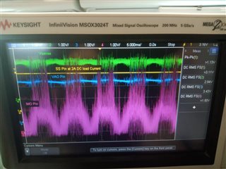

  • Hi Ulrich,
    As per your suggestion, we captured the SS-pin, VSENSE-pin, VAO-pin, and IMO-pin voltages at 1V/div at 5ms/div. The E_load is loaded at 2A DC.
    The IMO pin has more voltage spikes, corresponding wave (IMage2_ zero reference with all on the same horizontal plane, IMag1_at different plane) form is attached for your reference.
    Harinaik Sugali.
  • Hello Harinaik,
    Thank you for the waveforms.  They are very noisy, but I do see an issue.
    The SS voltage should not be stuck at 3V, but it should be up close to 6V.  Please check to see what is preventing SS from rising and remove the problem.
    Ulrich
  • Hi Ulrich,
    Thank you for the valuable information.
  • Hi Ulrich,
    The SS-pin voltage is more than 5V, but the issue is not yet resoled. The AC input current wave form is distorted (non sinusoidal). For your kind reference, the experimental result at light load is attached. What could be the issue?
  • Hello Sugali,
    I wish the cause was the SS pin voltage stuck at 3V, but since it isn't we'll have to look further.
    This is a strange situation that I don't understand. In the picture below, we can see gate drive pulses before and after the edges of the input current waveform.
    Where there are gate drive pulses, I expect to see MOSFET switching.  Where the MOSFETs are switching I expect to see inductor current.  When there is inductor current, I expect to see the average of that current at the AC input.  Above, we are seeing gate-drive with no current.
    Please investigate this chain of events to verify if the inductors are conducting current or not in the intervals between the yellow lines.
