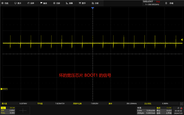

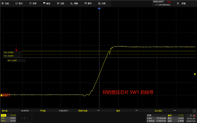

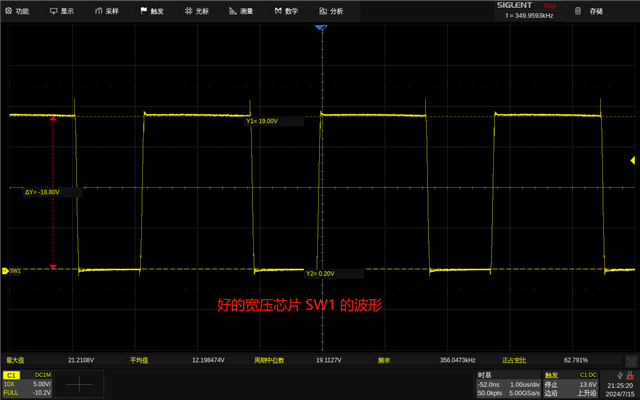

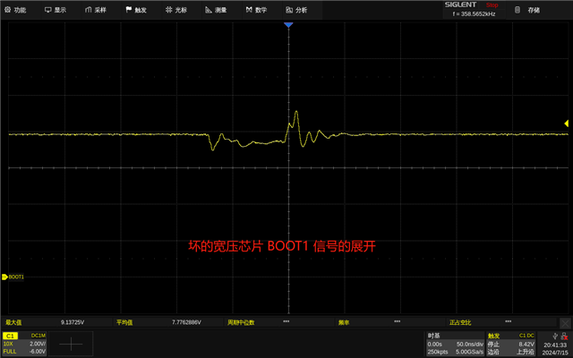

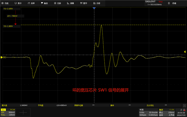

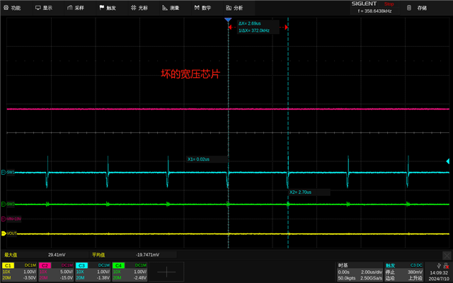

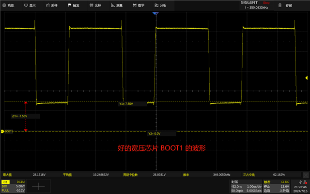

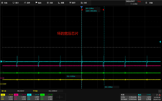

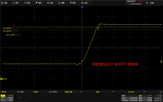

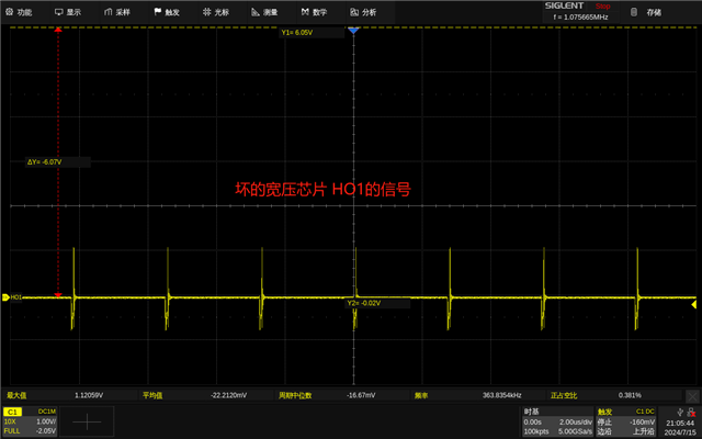

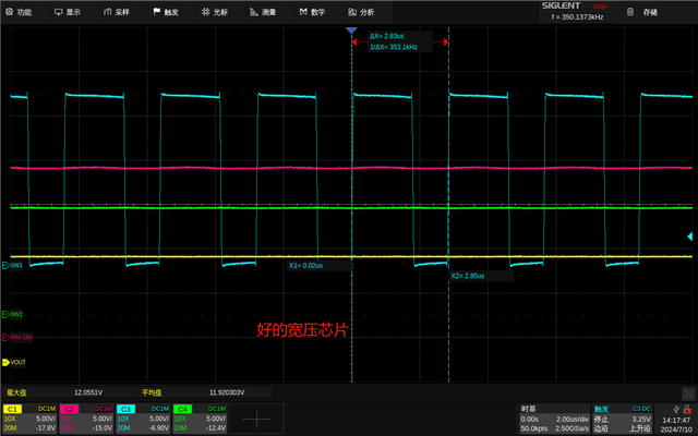

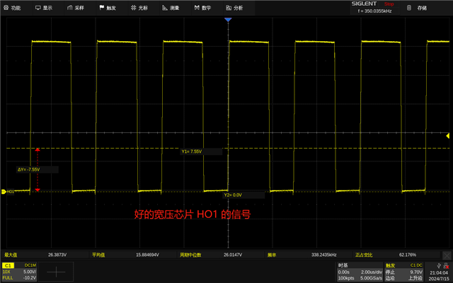

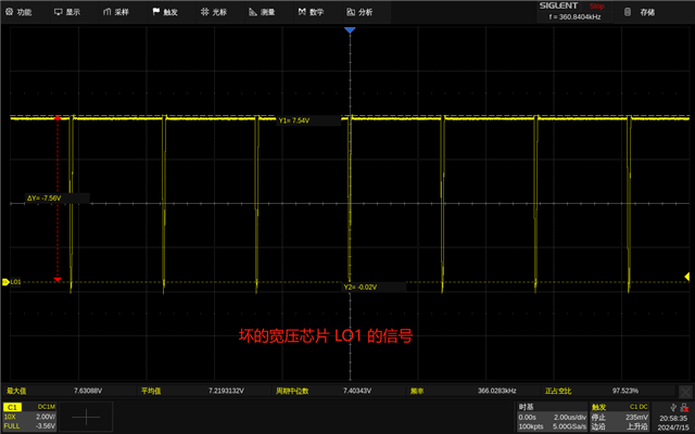

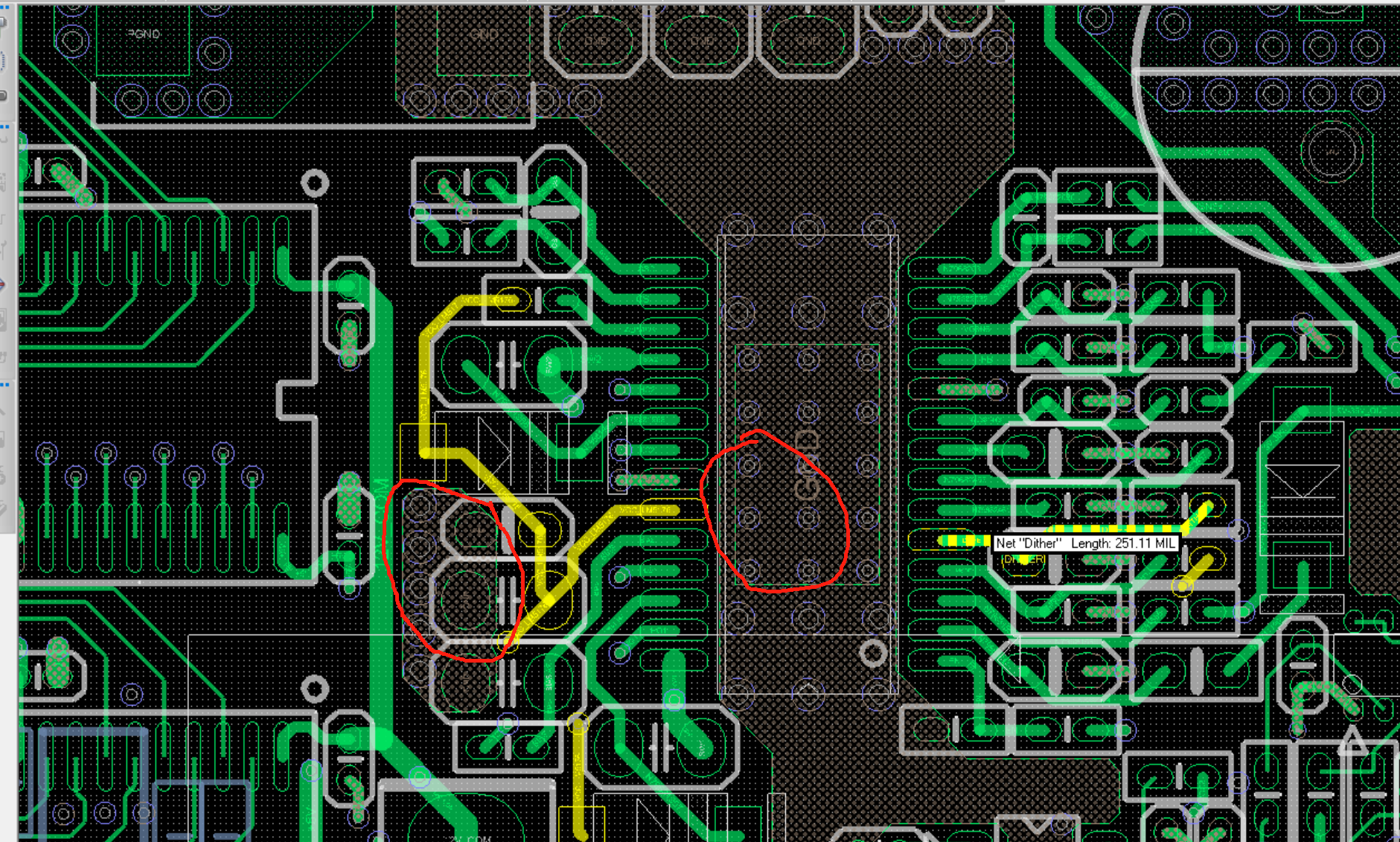

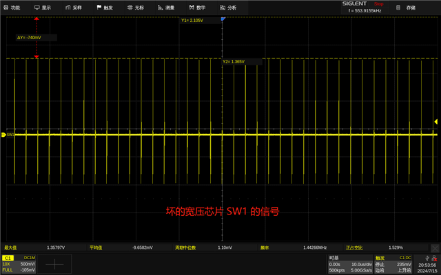

We use the LM5176PWPR for our power supplier circuit, the input voltage is 19VDC and the output voltage 12VDC,
Wwe found our board is failure, the LM5176 maybe damaged because there are no power output from LM5176(we change the new LM5176 that the issue is solved);
We check the circuit to get the SW1 waveform is abnormal: the highside gate voltage is 0V, and the lowside gate has the normal waveform; The SW2 waveform is normal;
Plesae kindly review our schematic diagram and PCB layout, and then provide your comment if there are any error for our design, thanks.
