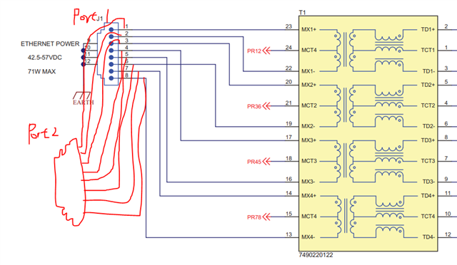

In our design we have two POE++ supported 10GBase-T RJ45 Ports. But we will be using only one port at a time to power our device(maximum power up to 70W) from an external ethernet switch.
My doubt is whether for the above case, can we use a single Powered device (TPS2372-4RGWR) to connect with two POE++-supported RJ45 ports.
If yes what are the things we have to ensure while designing the circuit and layout

    Thanks for the suggestion,
    Our query is we will be using two RJ45 connectors with magnetics to support Data+PoE.
    But our use case will be:
    1.  Port 1 as Data+PoE  & Port 2  as Data alone
    2. Port 1 as Data +PoE & Port 2 as Data+PoE

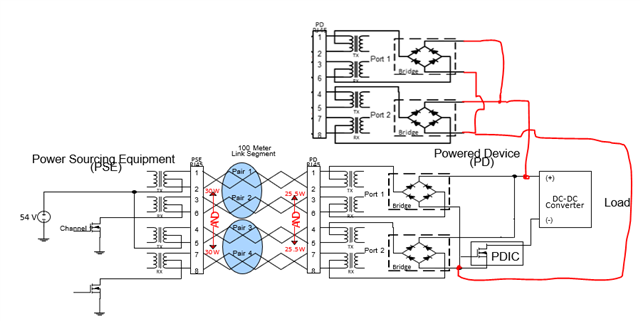

    For the above use case can we connect both the RJ45 power pins together so that it will be connected to the single-powered device(TPS2372-4RGW).
    Schematic reference,In this picture only RJ45 magnetics was shown, In our case can we connect two RJ45 magnetics power pins to a single PD?
  • Hi Mari,
    Thank you for your reply.
    If the case is one port with PoE+Data and another port is Data, it is better to have them connected after passing the rectifier. Then the PHY should not be comprised by the 37 - 57 V PoE voltage.
    I do not see an issue on the PoE side, while it is recommended to double check with the PHY team if there is a concern.
