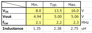

Hi team,
My customer want to check their inductance selection. Here is their calculation.
And they want to use inductor which have 20% variation. So the worst case is;
2.75uH > 3.3uHx0.8 = 2.64uH
2.75uH < 4.7uHx0.8 = 3.76uH.
So, they will choose 4.7uH for inductor. OTOH, our recommendation is 2.2uH. 4.7uH is still our recommendation?
Youhei MIYAOKA
    A 4.7uH inductor selection seems to violate the minimum ripple current allowed by this device, especially considering the inductance tolerance could add +20% (to 5.64uH).
    3.3uH should satisfy your listed specifications while maintaining 15% ripple at the lowest. Ripple must not fall below 10% of the max current of the device if you are using the 2-amp variant. Reducing your typical switching frequency to 2.1MHz using a very low tolerance resistor is also a often recommended for such a concern.

  • Hi Ryan,
    Np. OK, I'll recommend customer to use 3.3uH inductor instead of 4.7uH.
    Youhei
