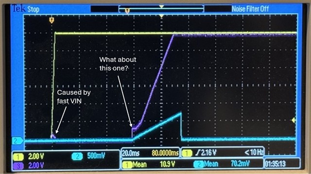

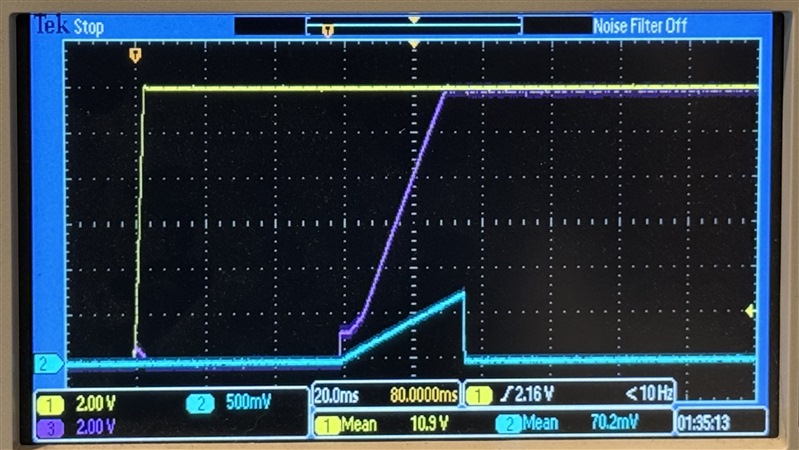

Hello, please see above the scope trace of the TPS259850:
yellow trace: V(IN)
blue trace: V(DVDT)
purple trace: V(OUT)
Good: V(DVDT), blue, starts rising smoothly when ENABLE, not shown, goes high.  This looks as expected.
Bad: V(OUT), purple, makes a sudden jump while V(DVDT) is still low.  It seems like the FET is being turned on temporarily by some other mechanism.  I did not expect this.
Does the TPS25985 have some other functionality that would turn on the FET while V(DVDT) is still low?
