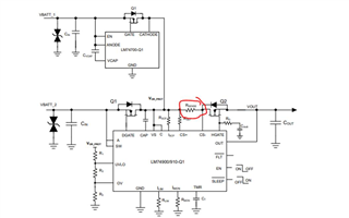

Hi team,
My customer uses LM74700+LM74900 in an ORing design. And they want to know whether the Rsense can be NC or not.
Thanks!
BR,
Grey
Hi team,
Thanks!
BR,
Grey
Hi Grey,
You can short the RSENSE due to which all the current protection features will be disabled. You can use LM74800-Q1 instead.
