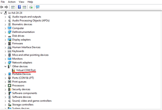

Connection Failure: When we insert the PMIC IC into the socket and attempt to connect, the connection is not established.
Virtual COM Port Error: The Device Manager shows a "Virtual COM port error." A screenshot of this error is attached for your reference.
Scalable PMIC GUI Connection Attempt: The Scalable PMIC GUI attempts to establish a connection but fails.

    As for the device recognition on the PC, the fact it shows you attempting to connect means the evaluation board is recognized by the PC correctly. The connection failing is between the microcontroller on the board and the PMIC.

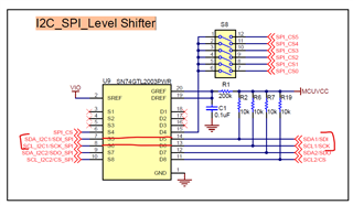

  • Hi Nicholas,
    I'm happy to report that I've identified the root cause of the PMIC communication issue. I suspected a problem with the I2C lines and upon probing, discovered that the U9 - SN74GTL2003PWR I2C_SPI_Level Shifter was causing the issue.
    Resolution for PMIC Communication:
    *Removed U9 (SN74GTL2003PWR) I2C_SPI_Level Shifter.
    *Shorted the I2C lines (schematics screenshot attached).
    *Confirmed voltage levels on both sides of the shorted connection are the same.
    With these changes, I can now successfully connect the PMIC to the GUI and program it.

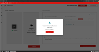

    New Issue During NVM Validation:
    However, I've encountered a new issue during the NVM validation page. When attempting to compare the programmed code with my .bin file, I receive a notification stating "unlocking EEPROM." Despite waiting for several minutes, the comparison doesn't proceed.
    Could you please advise on how to troubleshoot this "unlocking EEPROM" issue and complete the NVM validation process?
    Additionally, I'd appreciate your feedback on the I2C wiring modification. Is it likely to be causing the NVM validation issue, or is it a separate problem?
    Thank you
    Raj bhuvanesh
  • Hello Raj,
    I'm glad that you've been able to reprogram the units. Although we do not recommend changing hardware on the EVM.
    Several modifications have been made to the board already, please can you get a logic capture of the I2C1 lines when attempting this validation process, this will be the most helpful thing during this time.
    In terms of SPI and changing voltage levels, the device has now been pulled up to VIO & MCUVCC, again please take a logic capture.
    The unlocking EEPROM performs an unlock to the device, a certain set of writes need to occur in order as for the hang, I can not say at this moment without seeing the traffic on the lines.
    BR,
    Nicholas McNamara
  • Hi Nicholas,
    Thank you for your support in resolving the PMIC programming issue.
    I'm happy to report that I was able to successfully program and validate the PTPS65931211RWERQ1 PMIC
    NVM Validation Issue: "Unlocking EEPROM" notification during NVM validation. This issue seems to be related to a loose or faulty socket connection. After carefully reseating the PMIC in the socket a few times, I was able to complete the validation successfully.
    Thank you again for your assistance.
