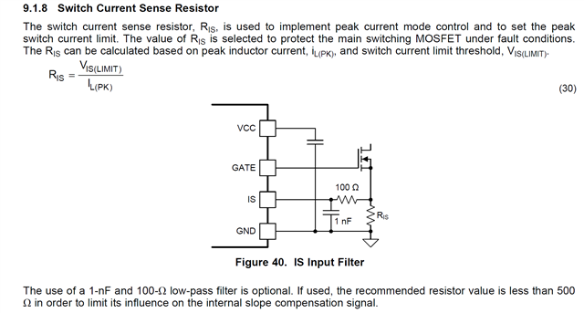

The TPS92692 is not starting in a standard boost configuration. I used the boost design calculator spreadsheet to get the component values for the design.

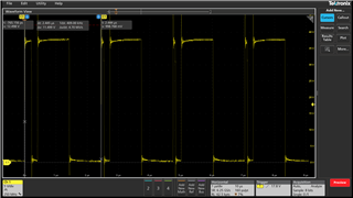

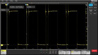

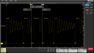

It appears what is occurring is the duty cycle and switching frequency are not stabilizing which is causing the inductor current to rise to a level where the switch overcurrent fault is occurring (IS < 250 mV)
