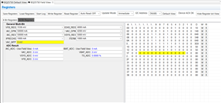

I have an issue that I believe has killed 2 spendy boards. I am supplying 42V 8A DC from a benchtop PSU on J1, a 10S Battery pack (currently at 39.4V) attached to J3 and have a DC Load attached to VSYS (RIGOL DL3021 set to 500mA).
I replaced R28 to 260kΩ and R64 to 10kΩ for approximately 1.56V on FB. ACUV reads 3.8V
I can Power J1 with 42V and VSYS is enabled and outputs the 500mA. As soon as I plug the Battery in to J3 the board stops functioning. BATSRC and BATDRV are shorted (I believe in the controller). I can still power the board through J1 and read the registers through the EV2400 but I get an Undervoltage error and the VSYS is disabled. I read 1.4V on ACUV but I do not know why it has dropped. I cannot get the output on nor the battery to discharge or charge. Any help would be appreciated.

  • I am hesitant to plug the battery into my one remaining board. R22 and R25 are bad on both boards, reading 1.3kΩ for R25 and about 600kΩ for R22. I replaced them both with new 10Ω resistors. I connected J1 to a 32V PSU so I could read the registers. I was still not getting a Power Good signal so VSYS is disabled. I then turned off the PSU and plugged a battery in by itself then VAC. It did not work and once again R22 and R25 are reading several kΩ.
