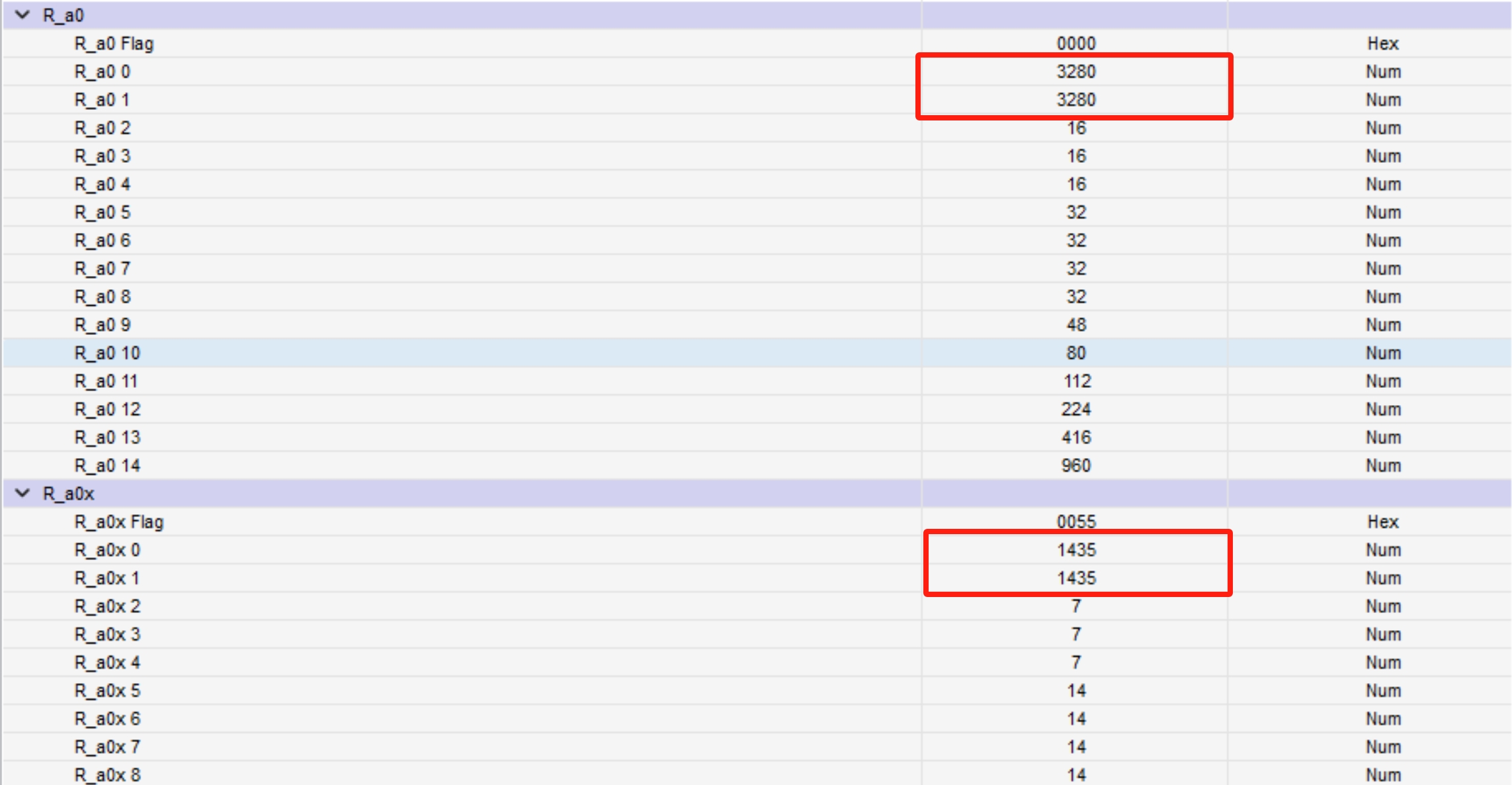

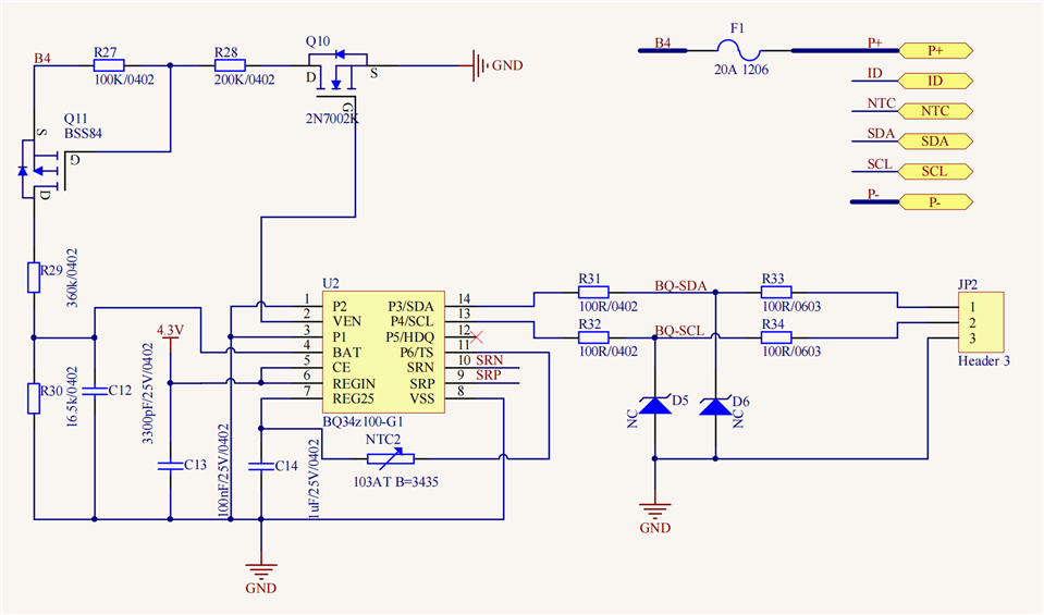

Hi
The battery pack is in good condition before shipment; After returning, it was found that FullChargeCapacity had been updated to 0mah, and RA had also been updated abnormally; The attachment contains the log and gg files after the exception; Can you help analyze under what circumstances such an exception may occur; ChemID calculation is within 3%.2425.gg.csv2425.log.xlsx
