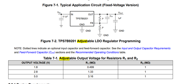

HI Sir
I need a adjustable LDO ,Part number
TPS7B92018DBVR is right part?
01:adjustable
8:???

Hi Alex, Zabbza,
We unfortunately will not be releasing the adjustable output version of TPS7B92, I instead recommend TLV709A01DBVR. We will be updating the TPS7B92 datasheet accordingly, apologies for the confusion this caused.
Kelsey
