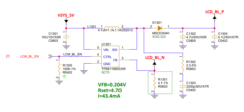

hi sir
i use the TI Power parts ,could you help to check it, thanks
hi sir
Hi Alex,
The schematic looks good.
BR
Patrick
