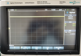

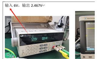

Hi
This product we use the same test circuit after the machine, the normal chip input 6 volts and 8 volts. The reference voltage is around 2.46
But 1pcs of them did not meet the test, please help to confirm the reason

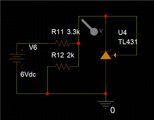

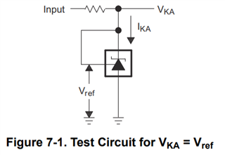

    Can you explain the purpose of R12 in your schematic? If you remove R12, does the issue persist? If you are looking to get a 2.5 V reference, this schematic should suffice:

    Can you measure the current across the 3.3kΩ resistor?  Please keep in mind that the minimum cathode current for regulation is 1 mA for TL431, so the current must be greater than that. If you decrease the input resistance or increase the input voltage to make sure that the current is greater than 1mA, does the issue persist?

    I would suggest decreasing the input resistor to allow a higher input current. The cathode current can be calculated by considering the input voltage (Vin), cathode voltage (VKA), input resistance (Rin), and load current. Please consider below:
    Input current = (Vin-VKA)/Rin. For your application, input current = (4 V- 2.5 V)/3.3kΩ = 455µA or input current = (8V - 2.5V)/3300 = 1.67 mA
    IKA = input current - load current, which means that for 4 V input with 3.3 kΩ, it is impossible for you to stay above 1mA cathode current, and for 8V input with 3.3kΩ, you are only leaving 670µA for your load current.
    I would suggest decreasing the input resistance to allow a higher input current while keeping in mind the load current that must be available, and then reevaluating.

    The decrease in resistance will depend on your load current. For example, assume this is the circuit setup you are using:
    Working backwards, let's say your load current (IL) is 2mA, for example. Since the minimum cathode current for TL431 is 1 mA, I will provide a bit of a buffer to account for any resistor tolerances, and design for a cathode current (IKA) of 1.5 mA. Now, finding the input current, this gives:
    IKA = input current - IL --> Input Current = IKA + IL = 1.5 mA + 2 mA = 3.5 mA
    Now that I have decided the input current is 3.5 mA, I can decide on my input voltage and resistor. Using the input voltage of 4 V, as you have in your application, and assuming that VKA in the figure above is 2.5V based off of its circuit configuration, this gives:
    Input current = (Vin-VKA)/Rin --> Rin = (Vin - VKA)/Input Current = (4V - 2.5V)/3.5mA = 429Ω.
    You can repeat this process for any desired input voltage, input current, cathode current, or input resistance while taking into account your application's load current. Please keep in mind the recommended operating conditions listed in the TL431 datasheet:
    In summary, the required input resistance for proper regulation will vary based off of your desired load current and input voltage.

  • Hi
    If TL431 is faulty, can this circuit confirm that TL431 under test is faulty
    The circuit you shared should regulate to 2.5 V, depending on what the load current is.

    Replace the faulty TL431, and the TP10 and TP12 test values are 0

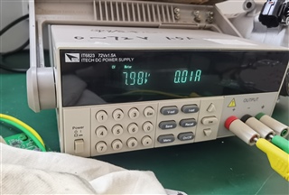

  • Hi
    Are you referring to the input for the following tests? This was measured with a separate circuit

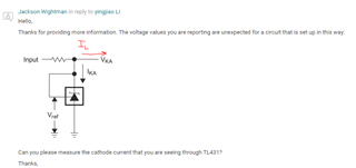

    Thanks for providing more information. The voltage values you are reporting are unexpected for a circuit that is set up in this way:
    Can you please measure the cathode current that you are seeing through TL431?

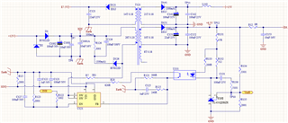

  • Hi
    In my application circuit, IL=40~50mA
    No load is drawn in this test circuit in the drawing below. We should be taking what kind of load to test
    Or do we just use this circuit to test I_KA?
    This is for this test circuit, Input takes the current at 6V and 8V respectively
    If IL=0mA for your test, that is no problem. I am asking about the IKA (cathode current). Please send me the IKA you are seeing for your test setup.

  • Hi
    When the faulty chip is tested, INPUT=6V, IL=0, IKA= (6-2.7) /390=8.46mA
