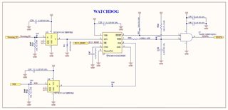

In one of our designs, we are using the TPS3851H33EDRBR watchdog timer IC. In our design output of Watchdog timer  (WDO and RESET ) are used to RESET STM32 controller.  SET1 is controlled by STM32 controller and MR is provided by another processor. I want to ask that, if SET1 is low then can we RESET STM32 by making the MR pin low which is controlled by another processor?
We want twd=20sec hence we chose Ccwd=0.27uF is the calculation is correct? Can you please review the attached design circuit if it is functionally correct or not and please suggest if any changes are required.
