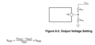

In TPS51385 buck regulator datasheet the formula for calculating the feedback resistor for setting output voltage is not mentioned. Please suggest.

Hi Sreehari,
You can use below equation. For TPS51385, Vref=0.6V. Thanks.
Aurora
Ok thank you, suggested equation not there in the datasheet, from where you got this equation and image.
This is the general formula for the BUCK circuit, which I found from the datasheet of other products. You can refer to this formula for calculation. Thanks.
