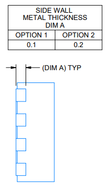

Hello Team,
Could you please let us know if we can choose option1 or option2 for side wall metal thickness?
I think this options come from difference of assembly site. Is that correct?

Shimada-san,
I am checking with our backend team to find the answer to this question.
Tim

Shimada-san,
I have checked with our backend team and this is likely due to different AT sites. Regardless, this will not affect performance, specifications, footprint, or any other usability concerns of the device and should not be considered a factor for designing in the device for the application.
Tim
