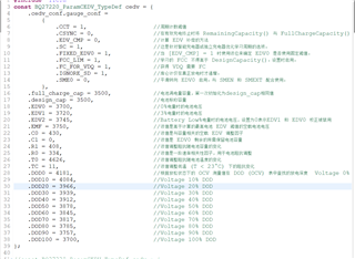

Hello sir,
I have a 2-cell 3.6-4.2V lithium battery parallel power supply handheld device, for some reason set 3.74V on low power shutdown, now the application BQ27220 measure the battery power, the test found that there is no way to learn the power and update, after the test voltage to the EDV2 threshold, VDQ=0, that is, the qualified discharge has not been completed, please ask me if there is a problem with this configuration, the configuration of the BQ27220 is as follows:
